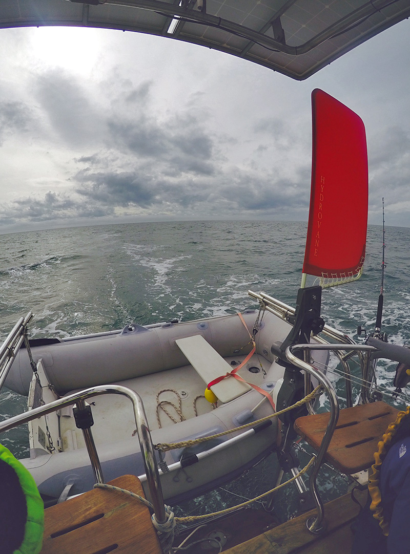

Sorry to drag the thread back up but thought a photo I took yesterday might help also. Ours works very well off center in all points of wind. Because the boarding platform is accessible, removing the rudder is easy without using tender.
Boat: 43ft 17t Displacement, Keel semi long.
Fitted: Off center, behind davits, under solar panels
