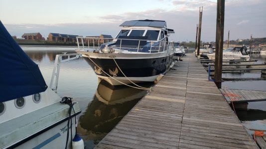

I have a 52ft Astondoa motor boat currently moored on the tidal Medway and was looking for any advice in regard to taking a trip or 2 into the non tidal side.
She is just under 5ft below the water and 14,1/2ft above as the radar arch has been removed. Beam is 16ft so she is quite wide as well.
I am worried obviously about Aylesford old bridge.
Any help or advice will be greatly appreciated.

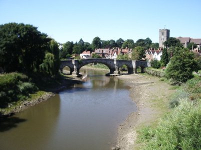

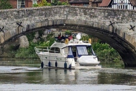

No problem with care.
Nip up to Allington and speak to the lock staff.
There are some Thames sailing barges up there and even bigger vessels.
Just a case of getting to Aylesford with the right amount of water under the keel and air draft above.
