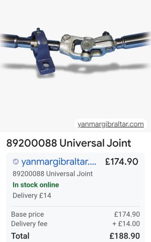

I want to renew one of my universal joint on my steering
Does anybody know of a direct replacment for those 19mm splined universal joint? Lewar charges over 300 euros and Cliff doesnt ship and/or is uncommunicatibe (I ma too far for him in the Canaries) other than saying landrover ones fit but are shorther and weaker....surely there is an automotive/agricultural replacment but without a serial number i could not find a solution.

Land Rover Defender steering has the same sized UJs but they are slightly shorter. Apart from that, they are a perfect fit. If the shortness is a problem, it is probably easier to have one of the steering bars lengthened to make up for the shortness of the UJ.
Jaguar E type steering column joints are the right length(i cant remember if it was upper or lower) but dont look as robust I have them as spares but so far haven't needed to fit them. I paid £60 ish each plus postage.
