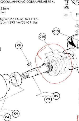

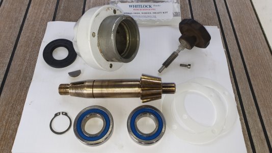

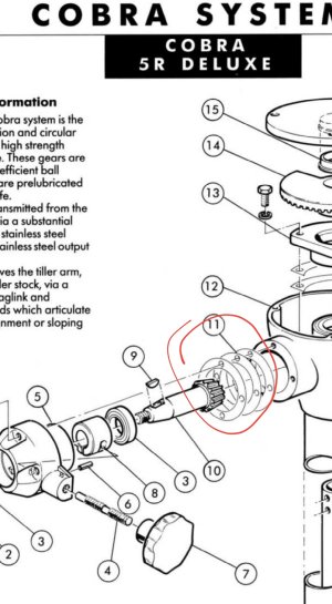

If the shims are missing on yours is that putting the bevel gears too close together which could cause notchiness? Can you improvise shims from gasket material or similar cut to the right profile at least to establish if it relieves the notchiness?
