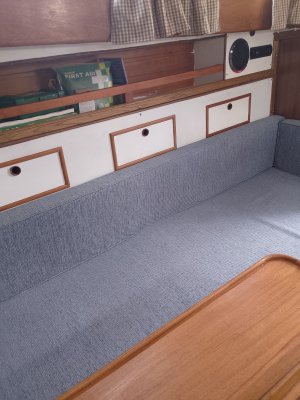

I used Dulux Satinwood on their primer for "difficult surfaces" for this job. much of the interior panels in my GH are "teak" melamine, but now mostly satin white. Used similar in my earlier Eventide. Photos of that taken in 2019, but painting done late 90s, so over 20 years old. GH obviously recent and not yet subject to hard use, but earlier experience gives me encouragement.
