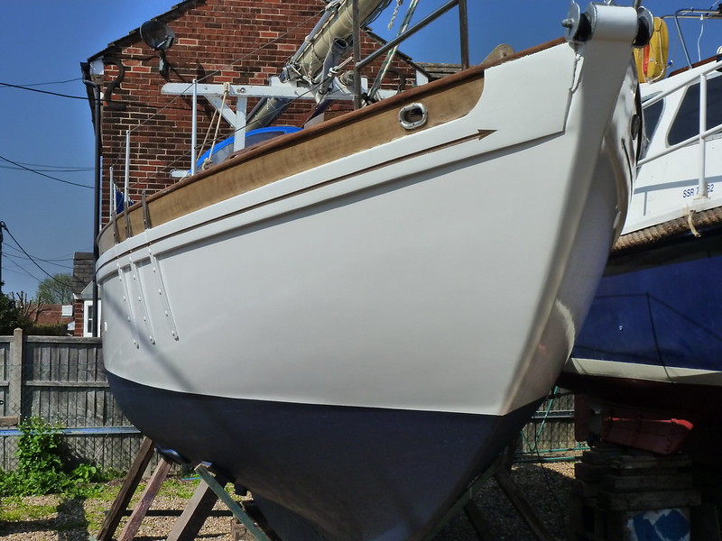

B & Q Old Gold - small little tin, needs several coats but can be applied one after each immediately after you have finished both sides. I can't remember the product but it is those little 'craft' tins. It stays and stays, cost very little. A small tin lasted about 4 x 3 coats: this is the product of 3 coats. Why on earth would peeps use sellotape or gold leaf! :unsure:
