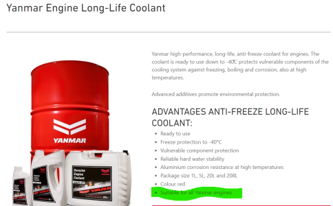

Hi,
I just want to double check what the correct coolant is for my Yanmar 4LHA-STZP diesel is. It’s red, and I’ve sourced a Yanmar product, photo below.
Any advice gratefully received!
TIA,
Kennedy
Hi,
TIA,
Kennedy
Yanmar Long Life Coolant, which is red, is suitable for all Yanmar engines.
