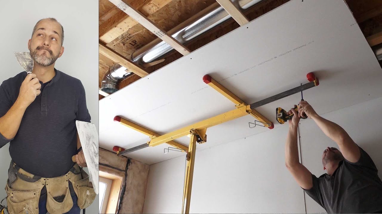

If I am gluing anything overhead on my boat I use prop to hold it in position until the glue sets.
Like a poor man's panel lift
