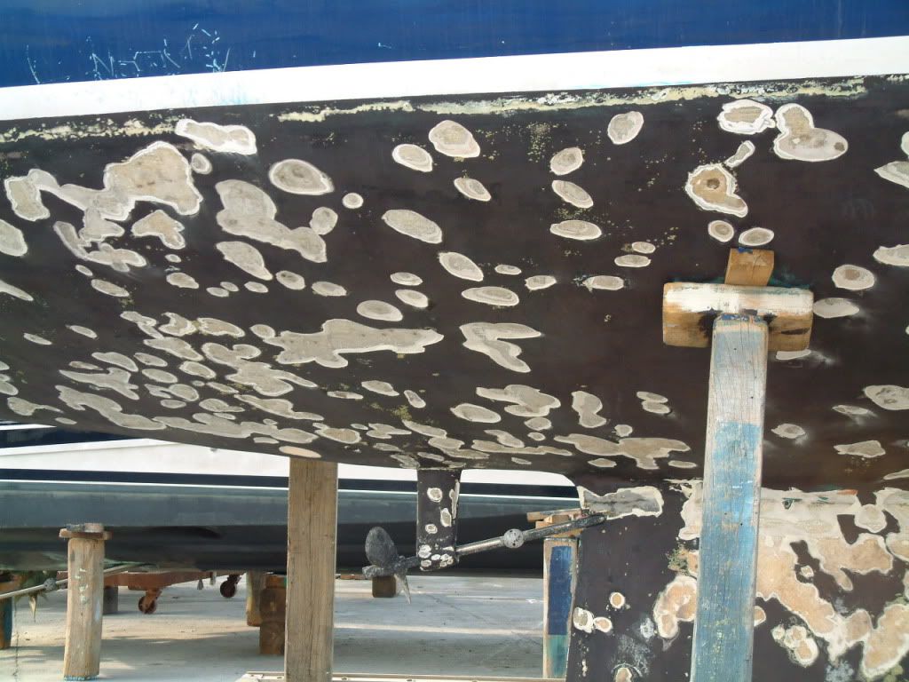

The blisters that you see are generally small (a few mm) and are present only in the outer layer. How much effect would a hole a few mm in diameter have on the structural integrity of the boat? Answer=None.
So your worry is "how long before a blister becomes a leak?" Well, the blister only affects the first layer of the laminate, and as it has taken several years to become a blister (and probably a bit more to become a hole) it will take several more years to become a hole in the second layer. And then it will take several more years to become a hole in the third layer.... etc. And when it finally does become a hole all the way through -- how difficult will it be to mend a small hole ?

Surface or gelcoat blistering is not a structural problem. It is a problem for perceived value though.
Osmosis can cause significant delamination, but in my experience this is rare. The thinner the hull, the more significant the structural deterioration.
If the boat is cored, the laminate is very thin and therefore inter-laminate blistering effects the structural integrity of the hull to a much greater degree. Also moisture can penetrate and degrade the core. Any moisture in the core may be very difficult to remove, and hence could seriously effect the cost of repair.
A friend has a Sadler 29 with osmosis and I once ( with his permission) explored one of the blisters with a small screwdriver. What came out was a soft mush and I didnt hit solid GRP until about 5 mm into the laminate. So my guess is that untreated blisters will eventually penetrate the hull depending on thickness and needing a lot of time to get there. But it will happen and indeed I once saw a piccie by Staton-Bevan ( a very good and well established surveyor) showing a bad osmosis blister with a screwdriver going right through the hull.
