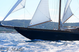

They have been around for donkey's years. I had a self-tacking staysail on my 1908 gaffer. They work pretty well but the big mistake is to substitute one for a conventional genoa because the loss in area affects performance. In boats designed for them they are good. Here's mine...
Note the special clew arrangement as you can't adjust the twist by moving the sheet fore & aft.
