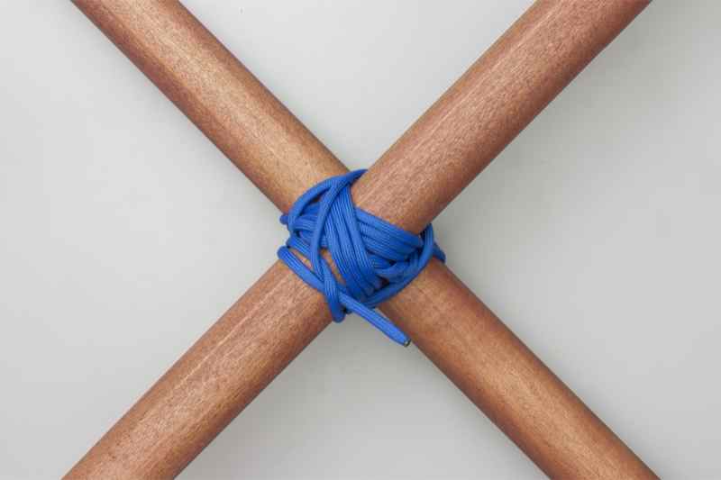

the fittings suggested need an 'end' to slide over so won't do it, as macd says above. What i want is a fitting that does the equivalent of this:-
All these answers appear to answer the question if you want to mount the 'end' of a tube to the middle of a tube at right angles...
I had imagined that the OP had wanted to mount one pole at right angles to the pulpit - but in the shape of a cross.. therefore no 'tube end' to slide into a lug.
