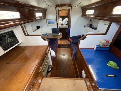

Hi,
My chart table in the CO32 was dreadful. Horrible wood effect Formica on top of nice plywood. Unfortunately they made it so you could not open the lid more than a few inches so I cant reuse the wood. Ive removed it and want to replace it with something thats got a nice warm colour to it. I still have not decided if im going to have a gloss or matt varnish finish.
The last boat I just used an old offcut of plywood I had, no idea what it was but the varnish brought out a nice colour. Ive no idea what to use, So thought I might ask the experts. Ive added a pic of my last boats chart table and it had no veneer on it. Of course a veneer would be nice but id like a wood that will give some colour.

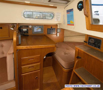

The original chart tables were teak faced plywood edged with solid timber, with a raised lip at the front. This hides the edge of the ply and protects the veneer. You can pick it out on this snap, though the detail changed over the years and this is not a J Rogers standard boat:
Courtesy Yachtsnet,
So you could get a piece of cut board and start from scratch.
The problem with re-veneering is that it leaves the edges a bit vulnerable to lifting and damage, so better to take off the lips, veneer the board and then re-apply new lippings. Quite a bit of extra work. I have just today varnished mine after thinking sod it I can't face redoing it properly
However, as you hate it as it is, it's worth giving it a go. You can get iron on sheets, though I have never used them myself:
Real Wood Flexi Veneer Pre-Glued Iron On - Choice of Species - 2500x300x0.6mm | eBay
If you get hold of solid veneers you can hot iron them on using quality, waterproof PVA. You need a bit of patience and technique but it works.

I am a formica guy.
Looking at your photo I see an ugly blue formica chart table on the starboard side..
It is in reasonable condition with no real scratches, stains, whiskey ring etc , but the worst colour that anyone could choose.
My guess is it was in the cheap bin.
In the ports side I see two wooden veneer counter top/stove covers that are scratched, dinged, varnish lifting, water stained.
I would cover both sides with a more attractive ( and there are a million design/ colours to choose from) formica.
Easy to wipe up spills. Scratch and stain resistant. A light colour brightens the interior. Easy to fit. No need for varnishing.
Cheap and easy to get you hands on.
Redo your table to keep some wood aboard.
Gary

Thanks for the complements!!, that was my previous boat finished!! the formica was specifically chosen in that colour!!. Still youve made me smile a lot!!. The original Table was removed from that boat Too.
