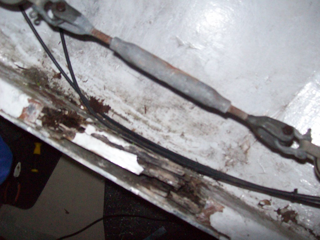

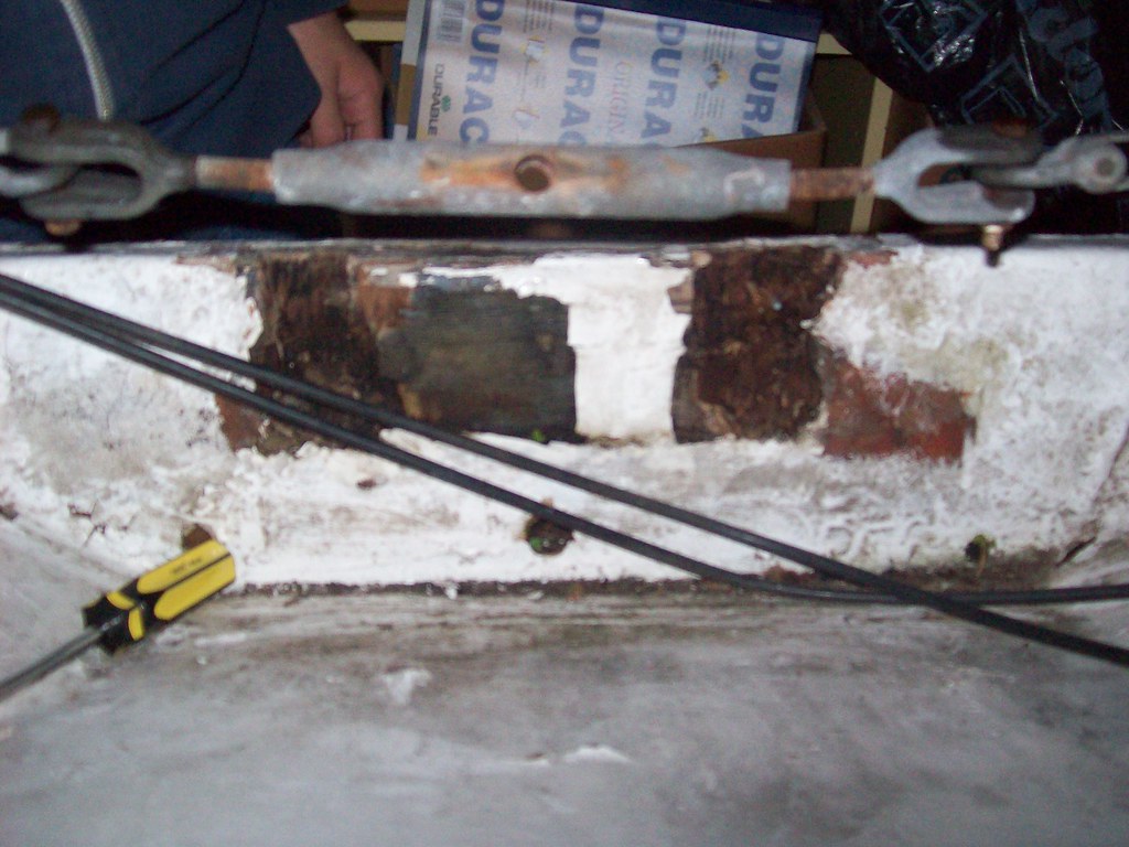

I'm a bit confused as to what steering system I have on my classic speedboat. I don't think it's Teleflex but I could be wrong. Can anyone identify it for me?

It is the very sophisticated Cable and drum system with rudder quadrant.
Most spares are available from any Fisherman's Chandlers. Do not use rigging wire only use flexible wire.
Yep. Just cable and pullies. That is a rigging screw, not quite correct.
You should have springs like these on my boat on the ends of the cables.
The input end
How do you connect the outboard then? I presume I will need a bracket to fit onto the outboard?
Sorry for all the questions :o
