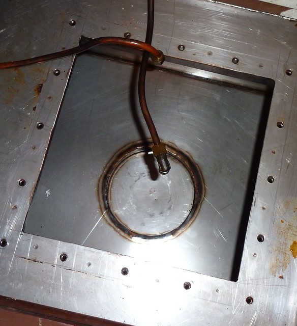

On both my diesel and water tanks I used a steel / stainless steel cover on to a rectangular hole.
I made up a internal frame from 5 mm thick stainless with M8 studs threaded into the internal frame held in with sikaflex.
The lid and the tank had matching holes with a 5 mm thick neoprene foam gasket There is no sealant between the top of the tank and the lid and I have had no leaks in 10 years of use.
