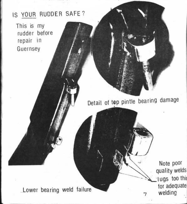

Ought to mention the rudder.
We believe they were made using mild steel screws ( we know they were! ) It also seems that the glue may not have been as waterproof as it should have been! I saw the photos of one that practically fell apart by itself.
The stainless fittings were also fixed with steel screws. They rust and the fittings can pull out. If they start to come out they fail ... happened to one member in mid channel. Also some of the welding seems to have been poor There is a design for better fittings in the owners manual but if it all looks Ok Id suggest drilling through the cheeks and the straps inside and through bolting.
Some members have redesigned the rudder blade shape to make it semibalanced. I have and I like it but the racing people prefer the original shape.
I never leave the rudder on so mine has not suffered at all. They can lift off and float away if the boat dries Every so often it happens!
Failed rudder fittings:
Look also at the bottom of the luff spar. There is a nylon bush. If it rests directly on the talurit splice it gets chewed up. There should be a slotted bearing block that fits over the talurit crimp to stop that happening..
