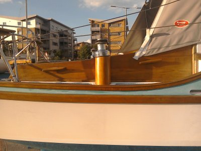

Varnish the underside and edges and paint the top with non slip or apply a Treadmaster pad for non slip. Or if you have a tine of Woodskin handy use that and do the handrails as well.
Not a brilliant picture but you can just make out the 2 seats at the end of the rail across the pushpit, just like the step on a pulpit. Done in Woodskin and looks like the coamings.
