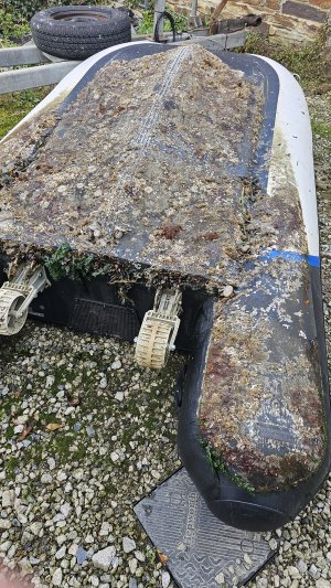

Just got my dinghy out of the water. It's been tied up at the pontoon all season. Any ideas for shifting this lot? I've tried a pressure washer but it hardly touches it.
If and when I do get it clean, what to do next season? Normal antifoul paint?

I usually just have a rummage in the shed 🤷
Brick cleaner is cheap and plentiful, I have loads of that, seems to do the job
Drop it back into the water (to keep it soft) while you get a cheap 3 or 4" paint-scraper, grind the sharp corners off that, then retrieve the dinghy and scrape it clean; that's worked for me and more than once
Thank you. I was a bit worried about doing that but I guess with round corners I can't do too much damage.
You may find that deflating dinghy and then rolling it .. may crack the attached crud and it start peeling off.
I would be extremely careful about scraping or applying acids ... no idea what may happen.
Repeat inflation - wetting and then deflating / rolling etc ...
Thank you. I will give that a try.
If you buy brick cleaner make sure it is one which is (hydrochloric) acid based. Eg Bostik Cementone Brick and Patio cleaner
I notice B&Q have a range of products ( including the above) available on "Click and Collect" but not off the shelves. Current restrictions on the sale of these products I guess.
Thanks. Yeah, I was worried about those suggestions. It was an expensive dinghy and I really don't want to damage it.
I notice B&Q have a range of products available on "Click and Collect" but not off the shelves. Current restrictions on the sale of these products I guess.
Are you really sure I won't end up with a pile of PVC?

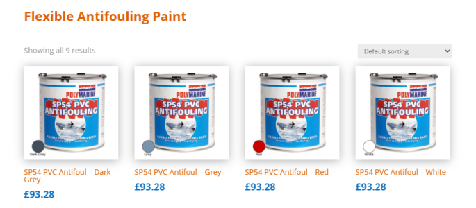

Moving on to your second question. . . . Flexible antifouling paint for PVC from Polymarine
I have no idea how good it will be. Probably not very but its only £93 a litre.
Cleaned up my second hand Avon with TFR. worked a treat but you could literally see it taking the colour out of the hypalon!
