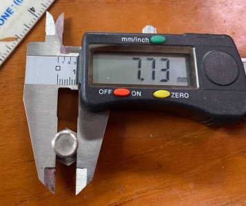

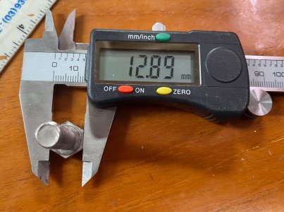

I've just done a head comparison with a bolt from my 'bolts that have no known home' box and this one is a match.
Don't know the length but 3 a side and maybe a 4th hidden under the teak rubrail.
Have you modified your baby stay ? If not I can send you some pics that will give you sleepless nights :)
View attachment 184497View attachment 184496
Thanks Frank.
And yes our baby stay has been modified It has a tie bar from the chain plate added internally down to a fabricated stainless fitting bolted to the stringer on the centre line.
