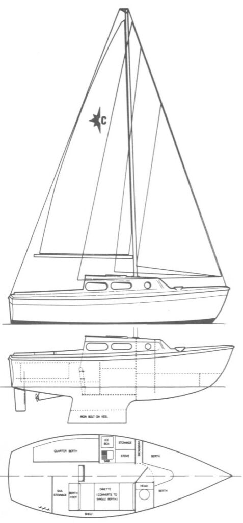

I can't help with the dimensions, but this drawing from Sailboatdata might give an idea.
