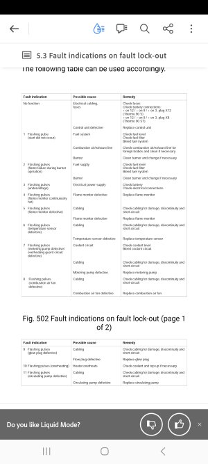

It's possible to fit a diagnostic 24v bulb or led to 2 of the control wires. This gives a pattern of flashes when it tries to start & pin points the component that has failed. See attached.
I can't recall exactly how to wire in the led unfortunately. My blower motor had failed.
