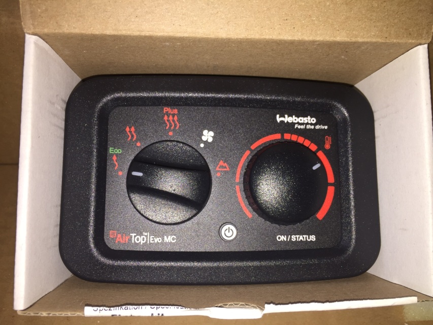

It started to play up a few weeks ago, the odd cut out while running, but no fault codes.
Then it took more start up cycles, ending up needing three or four before it would go, although every time it would light up and produce heat before shutting down, again no fault codes.
This was using setting two out of three on the control, eventually it got to five tries so I thought I"d better have an external look. Couldn't find anything wrong with the feed etc.
I thought it might be the flame sensor so was going to take the unit out, thought I'd try it on setting 1 which they call eco.
Fired up straight away and ran several hours until I shut it down. Did the same the next day and no problems on the eco setting.
It now runs fine on all the settings.....
Any explanations you can think of?
