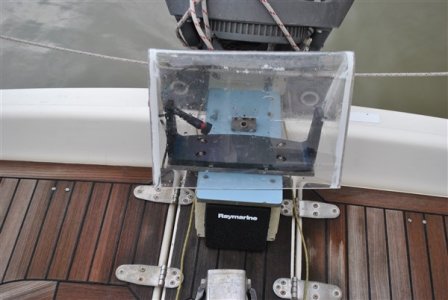

When in use my plotter sits behind my tiller. I have it there because I do not have a sprayhood & I could not reach or see it on the cabin top anyway. In this position it does not get obscured by a crew if I had one.
Because I wanted to keep the rain & spray off I made a simple cover from polycarbonate. I cut a piece which I laid over a length of scaffold tube & warmed with a heat gun. It gently sagged over to a nice curve & the right angle. I cut 2 pieces for the ends. I did not know what glue to use so I used Sticks like to form a fillet to hold the end in place. A cord stops the unit going overboard .
I can see the plotter through the polycarbonate & if I want to adjust the plotter it is easy just to flip it back out of the way. When the plotter is not in use I cover the fitting & the ends of the connecting lead as can be seen in the picture
The plotter bracket rotates. The dial underneath is for the autopilot
