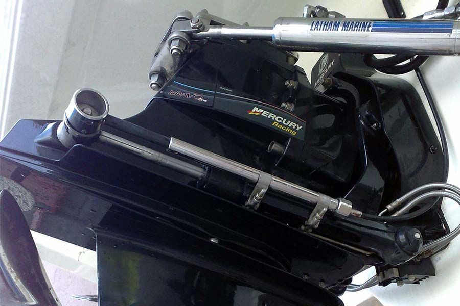

Not sure if it qualifies as clever, but since you asked for ANY ideas, you might consider getting rid of the dodgy electrical indicators altogether.
Wherever an accurate and reliable trim indicator is important, a mechanical push/pull cable is just the ticket.
You can see it in this pic of my old Fountain. Which btw was factory installed, as it is in several other US speedboats - which tells you something about how much some builders trust the original Merc indicators...
I don't think the necessary parts are expensive btw, but you should snake the cable from the outdrive to the helm, and find somewhere in the dashboard to fit the indicator. Which means a bit of work obviously, the reward being a very reliable and accurate system.

Simple question, simple answer: no.
Any electronic indicator on equipment hydraulic driven and exposed to salt water is INHERENTLY flawed, because it's bound to be inaccurate even when it works, and prone to frequent failures.
That's the reason why every speedboat builder worth its salt fits the mechanical indicators I posted earlier.
If it were just a matter of fitting a better connector or whatever, they would have done just that, I reckon...
