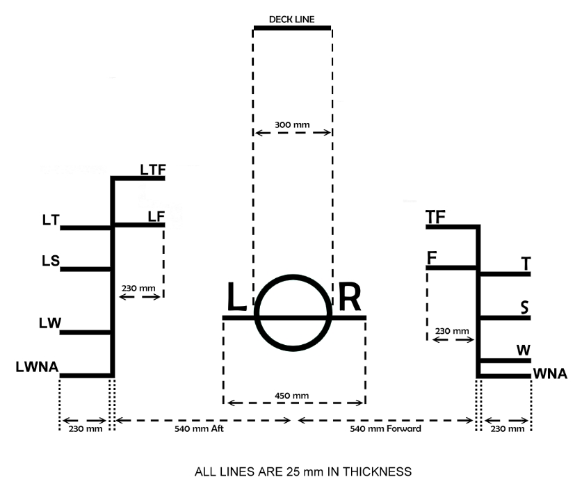

That is the reason cargo ships have different load lines marked, if loaded to F when i fresh water it will float at S when in salt water.
S – Summer Temperate Seawater
F – Fresh Water
