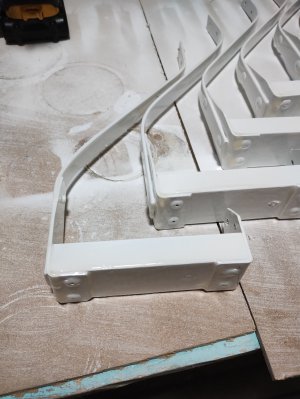

Living in Tenerife especially in the south is great for living and sailing, that is if your not waiting for the post. Any parcel coming to the canaries has a very good chance of getting stuck in Madrid Customs. I have had parcels waiting 4 weeks to cleared and I am currently waiting for a lift pump for my vp2003. I have had Merak now for 3 years and am yet to go aloft. Weighing in at a little over 16 stone I have been working towards grasping that nettle. I decided over a year ago that mast steps and losing a bit of weight would be the best way forward. The problem with living here is that materials are not readily available so simply bending some 4 or 5 mm aluminium flat bar was not an option. The thickest material I can buy hear is 2mm but I did find some 3x20. I have made 20 steps using 20*40 hollow section filled with foam, primed, painted and finally sealed with epoxy. I will probably have them fitted before my lift pump arrives.

Nice job making the steps. However you will not lose weight. You will not enjoy being up mast. I would have suggested mast lowering or removal. But good luck anyway. ol'will

They look very well manufactured.....are you going to put on a non skid surface ?

Unfortunately my small pension will not stretch to mast removal and I am not going to enjoy going aloft but I'm sure its better than Antifouling. I am looking at changing the standing rigging and back stay to Dyneema and building my own ultrasonic antifouling system.
They look good. How did you "fix " the ends to the tube section. Is there a hidden bolt/ rivet or did you weld them?

Some of that antislip tape they use on the front edge of steps would be good.
Here, if you DIY a boat, there are rules about non slip areas on deck and the tape is acceptable. Did you rivit the bits? I can see one on the curvey brace.
I bent 40*2 aluminium and riveted them underneath the 40*20 so the rivets are not under load. The bends are have a slight radius to reduce the possibility of a fracture point.IMG_20240729_165058724.jpg
Neat looking steps, but why fill with foam?
I filled with foam primarily to coat the inside of the aluminium with Polyester to inhibit oxidation, maybe a bit OT but why not. Could also fit the upper ones with auto floatation bags :unsure:. Also I had a half empty can on the shelf and was amazed that it still worked 😃

I take it that the step part will be screwed rather than riveted to the mast
Just curious, as I make quite a lot of SS bits for friends boats. Do you have a folder?,or careful bending in the vice. And, type of rivets? Last time I was up a mast after storm damage, I used monal. Two legged riviter, but a real pain (literally!) to set them, 6mm. Tempted by one of those riviters that works with a battery drill.

I am using 4mm Aluminium Rivets, three in the base and two on the cross brace plus some very strong sealant to fill any voids. By using aluminium for all the build I am avoiding problems with Electrolysis via dissimilar metals. The material is only 2mm thick at the base so avoiding corrosion at this point is critical. The sheer strength of a 4mm Aluminium rivet is well over 300kg so I have a very high safety factor. I don't have a vice or a metal Bending Machine, I clamped the aluminium between two steel flat bars on the edge of my folding work bench bending initially by hand and finishing with a hammer. It would be great to have a workshop with tools but I make the best of what I've got and only spend on what I have to.

It doesn’t look (from the photo) that there will be room for the rivet gun on the bottom three holes

Also, how flat is the mast at that point? Three in a row depends on a curved bracket, or a flat mast?
Some time ago I fitted some glass filled nylon folding steps with 5 mm aluminum rivets but could not get riveter nose into the lower rivet holes, so I used M6 socket cap heads set screws in SS to fix the steps to the 5 mm thick mast using an extended ratchet tap wrench with the mast up hanging from a bosons chair
