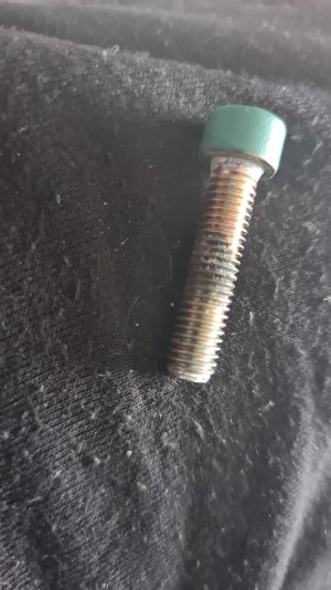

Hi all,
Need to order new bolts for the end caps, not sure what the exchanger is made of though to pick up bolts locally. I assume it is cast bronze or something similar (D3 190)
The bolts are slightly yellow and magnetic.
Would 316 be okay with anti seize?

2 reasons mainly.
1. I needed them quickly (which I've now got)
2. No one wants to pay volvo penta tax for a bolt in a packet.
6x bolts and 3x O rings from volvo to fix the exchanger would have been £ £110.
Local hydraulic place had the seals and same bolts £23 total👍
Ironic as the reason I'm fixing it is volvo kindly stripped the bolt on it when it was made and painted over it.

Although £40 for 6 screws does seem a tad excessive, in the grand scheme of things it is a drop in the ocean to ensure you get the right material. Galvanic corrosion on your heat exchanger could end up costing over £2.5K.

Correct, should be zero water👍
The bolts hold the end cap on. They should not come into contact with any liquid.
Should, being the important word. A slight weep on the end cap is all that it would take. Or a leak anywhere near on the engine, or just one of those salty damp engine bays that boats often have.

Dude, it's a bolt that was replaced with a suitable one, not a b&q special.
This might come as a surprise, volvo do not make bolts, paints, antifouls, oils, filters, anti freeze, timing belts, pistons, bearings etc etc.

Corrosion only takes place when you have 2 dissimilar metals electricity connected together in an electrolyte (sea
water)
As there should be no electrolyte in the cap screw threads there should be no corrosion.
I did have an aluminum heat exchanger corrode due to a failure of the end cap seal
Check for any seawater leakage
I had my heat exchanger welded up and hand fled back to the required shape

Unfortunately we haven't found much yet we can put in contact with salt and not corrode to some extent.
My boat is dry stacked so does help.
