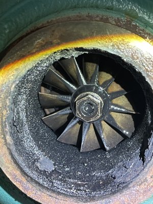

Update: The turbo was indeed stuck. I’ve managed to free it with some WD40 and lots of turns.
It now rotates freely for about 1/2 a rotation and with a little bit of resistance for the other half.
I didn’t have time to run it today, but hopefully a good blast on my next visit will prove if it’s resolved.
On the external exhaust side the turbo didn’t appear to foul; I’m guessing the fouling is further into the actual body on the exhaust side.
Any recommendations on how to clean it further / properly?
Pic of the exhaust side attached.
I’m glad you have made some headway into the solution. I’ve found that the turbo will come up with any excuse to stick so although you have made an improvement it still may not perform. Generally it’s the exhaust side that just rusts up around the sleeve, there is nothing else inside (except the bearing…..don’t think about that yet) until you get to the turbine on the inlet side. I’ve found that a scrape around on the exhaust side, where the turbine spins, with an electrical screwdriver does the trick. Suggest you try that before going to sea and being disappointed, it really should spin for a couple of rotations on its own.
The inlet side is easy so you could get some fouling there but my money is on the exhaust side.
Been there. Best of luck.
