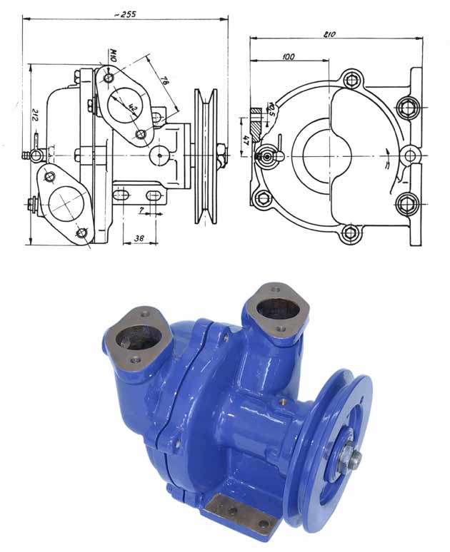

Possible to use pumps of centrifugal, or turbo type, - or however you call this is English... - not rubber impeller kind, but same kind as works in fresh water cooling circuit. But seldom fitted. I knew only one engine originally made with this type of pump for seawater, old kind plant for fish trawlers, river barges. Those pumped the sand through, no problems ;)
You may look for this, as it was based on 6 cyl Leyland type engine :)
The pump must naturally be made of bronze and such, not just automotive; but probably it can be found, and fitted on pulley.
Such pumps were also used as high output bilge pumps, engine driven.
Found it - something like this: http://www.wsk.com.pl/images/produkty/pompy1_11.jpg
http://www.wsk.com.pl/en/pompy1_11.html#
