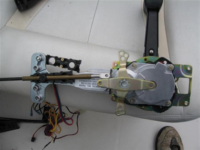

Here's a bit of an open ended question.
Friend with a Regal 2250 with a KAD32.
We didn't think of taking a pic of the throttle assembly before tearing apart, but it's the black flush-mount throttle with the tilt button built-in and also has a kill cord.
I have attached a pic of the plastic piece that joins the cable to the internal metal piece of the throttle.
Any gurus, can this plastic piece be purchased? It broke due to a stiff cable which we are also ordering... just need this plastic piece to get back in action.
Pics here: http://imgur.com/a/CxeQe
Just doing a bit of Googling, it appears to the be the plastic housing holding this cable to the throttle
If it's the Teleflex Morse SL-3 ... (Google to see what one looks like ... top flush mounted?)
http://www.freeportmarine.com/boat-.../teleflex-connection-kit-for-sl3-control.html
https://www.keypart.com/stock/212151-003
If not, try looking for the "connection kit" for that exact control box.
Looks like it, thanks so much! Going to get Googling now.
Wonder if that plastic piece if available by itself?
The throttle looks like the same that was in my S23, except for that instead of the "push button to raise outdrive fully" (which was on the S23), there's a button for the kill-cord
-EDIT- It's the side flush mount, not top flush mount! As mentioned above, just like the S23
The cable is not the standard 33c but either mercury mercruiser or OMC with the built in eye
The 33c has a threaded end so it is possible you may get the wrong parts
