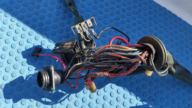

These are the relay/circuit breaker connections, the badly burnt red wires were connected to an 8a thermal breaker !

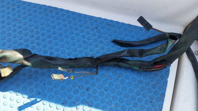

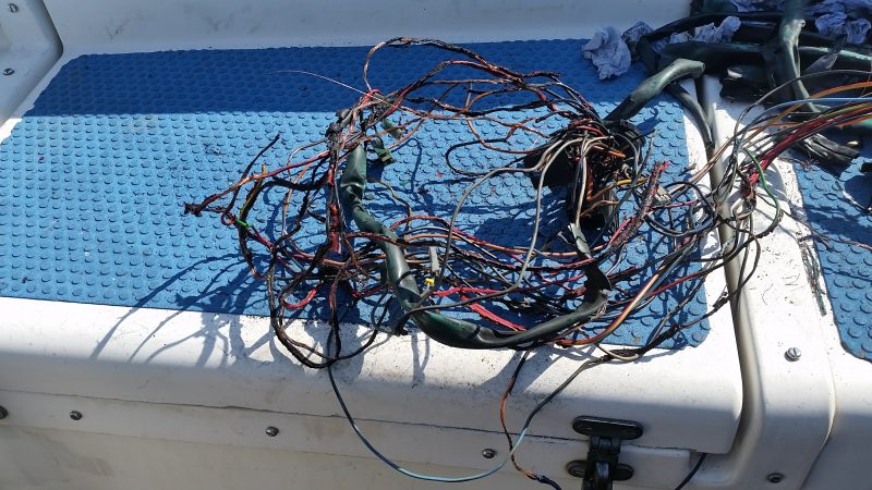

Couple of general pics, you can see in the second one that the red hot copper was starting to burn through the PVC covering :

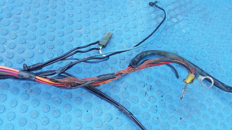

After removing the pvc covering :
Interesting and a bit scary.
Did the breaker not trip because the current was in limits?
It could be the stop solenoid wiring is never intended to operate for more than a few seconds, so is not sized for continuous use? Particularly when you take into account the de-rating needed for a wire in a thick bundle and the high ambient temp of an engine box.
So the root cause is the relay sticking shut, or the switch somehow continuously energising the relay?
I've found car relays unreliable on boats.

I think the breaker was faulty/old. Difficult to pinpoint precisely which part failed, but i have a feeling it was the relay sticking in the closed position, then the solenoid burning out internally, shorting the wiring. I don't suspect the switch, as it's a key switch and the owner had taken the keys out. He left the boat to move his car and came back to a boat full of smoke. Shows the importance of isolating engines when the boat is unattended, although this fault wouldn't happen on every boat. When i put it all back together we tried holding the solenoid in the energised position and it got uncomfortably hot pretty quickly.
It is possible that the key switch failed to de-energise the stop circuit despite returning to the "O" position and the keys being with removed.?
Technically you're right, but i don't feel that it did, can't be 100% sure of course. But to be absolutely certain i'm going to remove the solenoid connection from the key switch and connect it to a momentary push button switch, rated for the current draw of the solenoid and do away with the relay (wiring uprated were applicable). This will remove the risk of faults in the key or the relay and make sure that someone couldn't leave the key in the stop position. I'll add a red LED to the circuit to indicate that the solenoid is energised, so even if the button contacts stuck closed the owner gets a visible warning. That and new thermal breakers should keep it safe.
