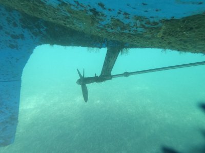

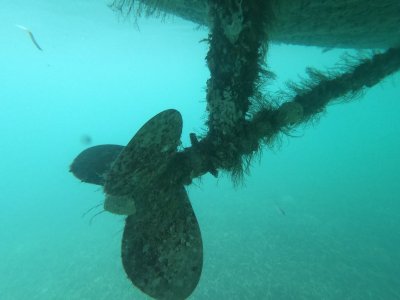

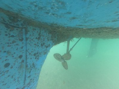

So yesterday decided it was time to check the hull and prop (as need to do that anyway prior to us departing the Caribbean to head to the Azores) ....see the pics! First ones are before I started to clean her up.
Started to clean it all up and not only was the prop fouled but also the prop shaft and the P bracket. The hull has what can only be described as a 1cm layer of growth which luckily comes off easily enough but what an effect that must be having!
Got most of it off by snorkelling yesterday and then spent 90mins diving under the boat to clean the rest off (as well as replace the MAXPROP anode).
We only antifouled the boat in November but we have been static on St Maarten lagoon for 6 weeks (a notorious place for growth and barnacles).

Update, with the bottom and prop etc all cleaned (and the fact that we are fully laden with all our liveaboard stuff including extra fuel and water etc) the engine now gets to 3000rpm and we get 7kt+ boat speed so quite happy with that!
