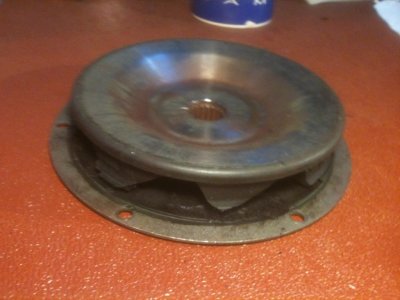

Can the vibration damper plate on an MD2040 fail in a way that would compromise the saildrive isolation without any associated drive issues, or would you expect odd noises, vibration etc if it was beginning to fail?

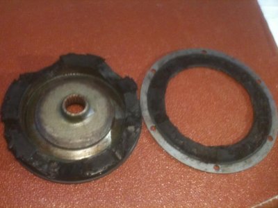

It can fail so there’s no drive at all. (Ask me how I know!)Can the vibration damper plate on an MD2040 fail in a way that would compromise the saildrive isolation without any associated drive issues, or would you expect odd noises, vibration etc if it was beginning to fail?
