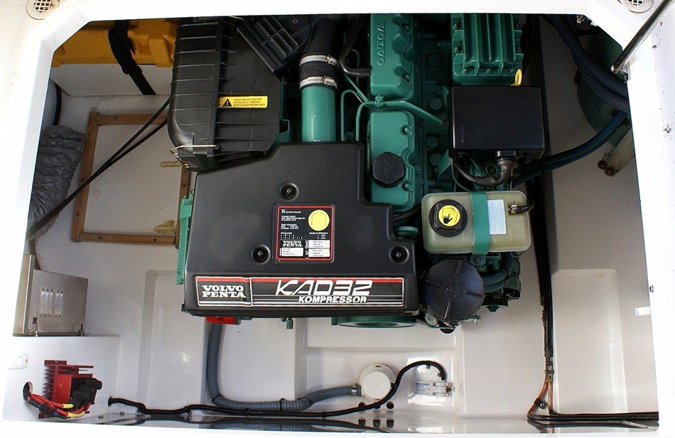

Here's a pic fro my first boat withe a kad32 when it would have been about 8 years old
