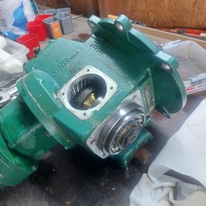

Just wanted to give an update to anyone else that has this issue....I've fixed it!!
In short, the brass selector cone was worn and rather than trying to regrind it, I replaced it along with the selector. This little brass part is almost £900!! If you can get someone to engineer it, great, but otherwise it's an expensive job.....which it was.
Gearbox is like new and slips in and out like a dream! First few projects on the princess are done. Next job is to find a good upholsterer in Essex.

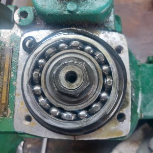

I overhauled my MS3B a few years ago and could not find a manual - so I wrote one. I expect your box might be similar.
Good luck.
Very good instructions! I am just about to strip down my MS3B. Regarding undoing the top nut, you mention holding the bottom of the shaft with a 21mm socket. The shaft is splined, 17 of them. Did you use a regular socket to hold against the significant pressure required to undo / tighten this nut? I was also thinking that it might be better to undo the nut before removing the box but not sure if the engine will give enough resistance? Would really appreciate you thoughts on both points. Thanks, Alan
