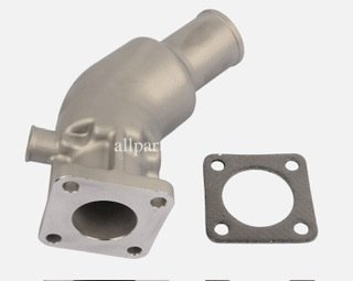

Hello all,
I need to replace the exhaust elbow on my VP D1-30. Obviously there are lots of different products out there with a big range in prices. But I found this one on eBay for about £85. I know, if it sounds too good to be true………
Just wondering if anyone has any experience of this particular item from eBay ?

There all over ebay and Aliexpress not heard any negative feedback .
Can you post a link Jon?
It would be interesting to know what material the seller is claiming the the elbow is made of.
Hello,
There are several on eBay. They all look perfectly legitimate and claim to be stainless steel.
I’m thinking I will buy one. The saving is quite considerable and if it turns out to be a mistake I won’t actually have lost that much (so long as it doesn’t snap off when I’m out on the water !).

Quite a mark-up if the other suppliers’ parts are coming from the same source. I would wonder about the quality of the stainless, but anything has to be better than the cast iron part. When I removed my exhaust elbow to decoke it, the spigot for the rubber pipe fell off. I’m glad that didn’t happen at sea!
Yes indeed. I think I’ll take a chance with the eBay part. Nobody has appeared on this forum and advised against it. I half expected a deluge of people telling me not to touch it with a barge pole !
