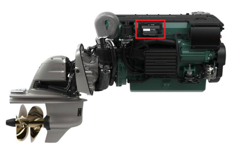

The PCU is the black box bolted to the side of the engine directly above the air filter - see the highlighted section below. It's held on by 4 x bolts and a single multi-pin plug that has a hinged locking tab along the bottom that will just pull away as you disconnect it, so really easy to remove.
