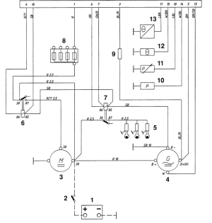

If you fit a modern warning light module with LEDs in place of one with filament bulbs you will also have to fit an excitation resistor ( 30ohms, 5 watt IIRC) #9 in the attached diagram for an MD 2010
