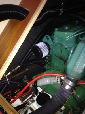

Since this is likely to require destroying the pan as its pressed steel, perhaps replace with a K&N filter from their universal range.
Pete
My next idea is to take the silencer off while running and see if I can see anything else happening inside the intake manifold.
I'll have a look at those K&N filters as its worth a shot for trial and error. I would think more clean air through one of those rather than a 30+ year old silencer has to be better for the engine too!
