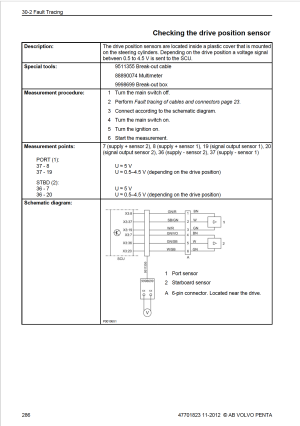

You probably need to replace the drive position sensor.
I had exactly the same pb. All solved after sensor replacement.

The relevant manual will depend on the EVC generation. The post above saying that the code in question didn’t appear in the EVC-2 manual is a perfect example, as those codes are a vastly different format to the earlier EVC generations.
As for the sensor replacement, these are the sleeves that are surrounding the steering rams on the outside. They can be removed by disconnecting the steering ram pins & sliding the sleeves off, after which you can pull the electrical cable down through the transom shield, ideally attaching a piece of cord or similar to use to install the new sleeve cable!
Reverse the procedure for the new ram sleeve/steering sensor (they are handed so make sure you get the correct one for the side at fault), auto-configure & fire it up and things should work themselves out automatically (ie the drive should return to its straight position on startup)

Thank you for the reply. Its a twin D3 220 setup with DPS-A aquamatics. I have steering failure fault and code mid 250 psid 9. The steering arm is internal and i can see the sensors. From the research i have done the sensors are parts of the steering ram and cant be obtained separately unfortunately.
