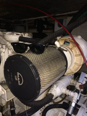

When one of my air filters drops off I can immediately tell by the inc in whistle , as the OP everything else Eg boost , and dare I say it but I will EGT s are the same .
Acts as a muffler as well as filter .
Just one 13 mm clamp and they can + do work loose .
