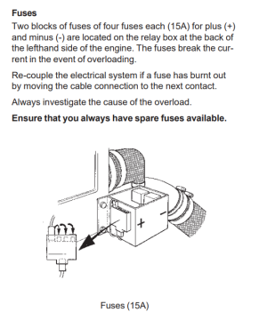

What version of the engine . One of the later ones or an early one with an isolated electrical system.

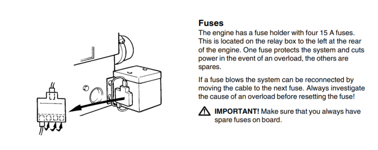

Early versions with an isolated electrical system have two fuse blocks as described in the text, one in the positive and one in the negative, but it is irrelevant to the thread because the OP has stated that he has the D version ( I had not noticed that)
The second snip is the relevant one and illustrates your statement
