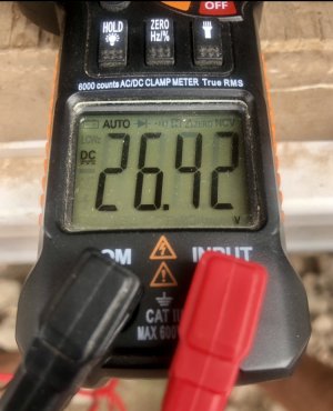

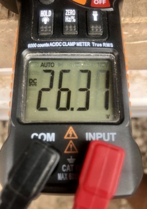

I should mention the fridge doesn’t cycle all the time, kinda frustrating. Anyway I monitored volts as it cycled and didn’t notice significant voltage drop. Power source is a LiFePO4 24V battery bank.
Fridge Off
Fridge On

if the run from lifepo4 bank to fridge is not massive with v.thin wires you can rule out voltage!
