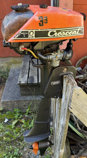

Hi @neil_s (or others who might know)
The origianl author here «StevenSeagull» seems to «have flown» somewhere else ;-)
I do have the same Crescent 3.9 hk which I just recently manged to clean up the carburator and adjust the spark plug gap.
Then it started beautifully!
I have search a lot without sucess for «parts list» or «split drawings» to find where the impeller (if there are any?).
I could not see any water comming out from the small hole half way down to the propeller?
Neither did I understand how to dismantle the rod to discover any impeller.
Both you and others have hinted that the motor is air cooled?
Does that mean, there are no impeller to change or fix here?

Welcome, Kjell_arne! - the cylinder is air cooled, but the exhaust manifold and leg are water cooled by means of a scoop behind the prop - so no impeller. There is no piddle hole, either, so failure of the water flow is only detected by burnt fingers!
