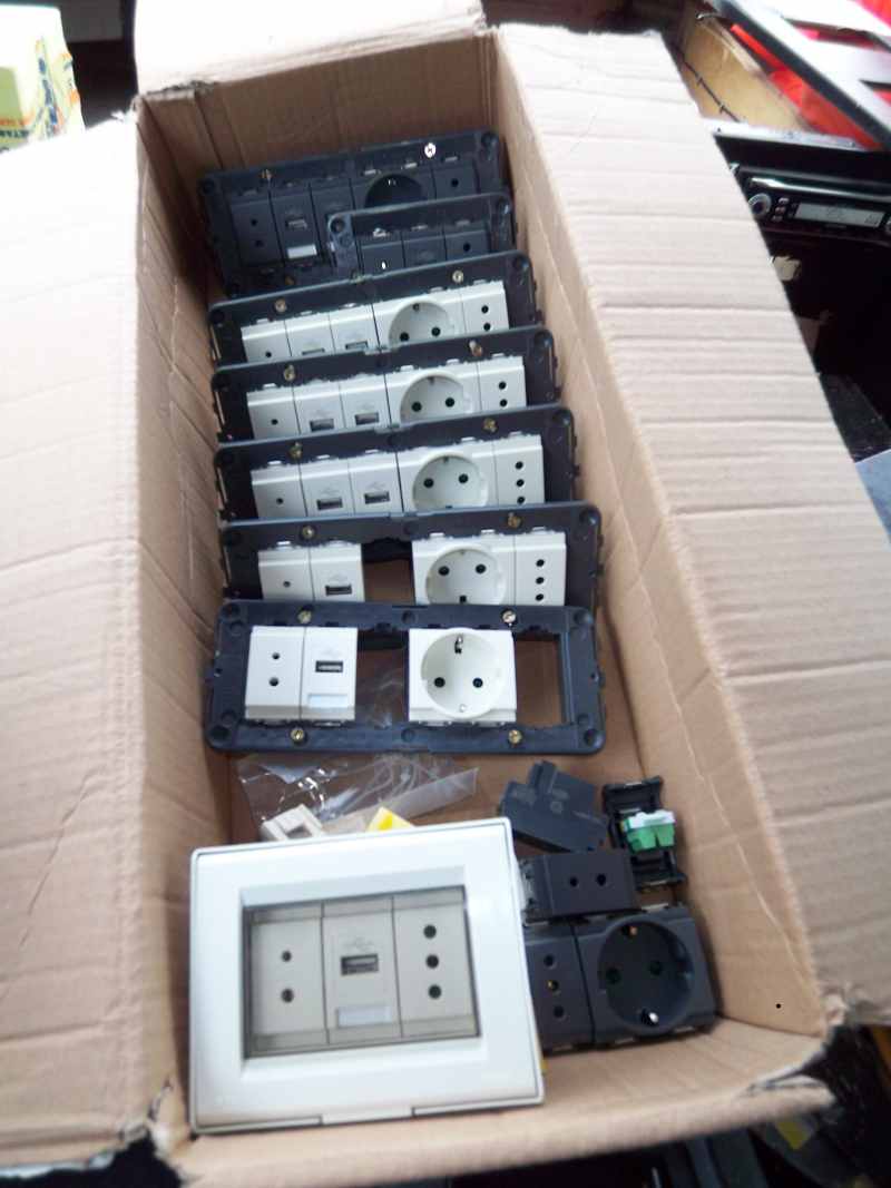

I LOVE Vimar kit!
MiToS is the third installation (after two houses) and I'm again using IDEA stuff.
Check this:
yes you can mix and match, I'm putting 24V 2 pin, together with USB 5V for charging stuff, plus (being EU and not UK, 220V 2 pin sockets for inverter and proper 220V shucko for shorepower/genny work.
All in 6U.
Having fooled around with various kit, I'd say they are top of the range, so your comment on not happy with quality is a bid odd!
What type are you getting?
Also there are IP55 or what for ext installation (will be using one on the f/b)
if I could be of any help, let me know!
cheers
V.
