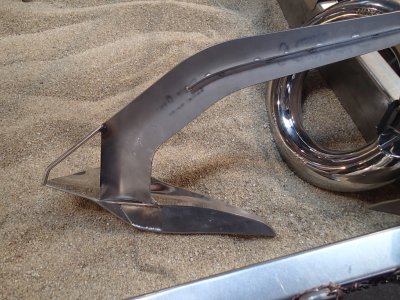

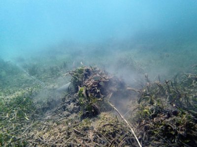

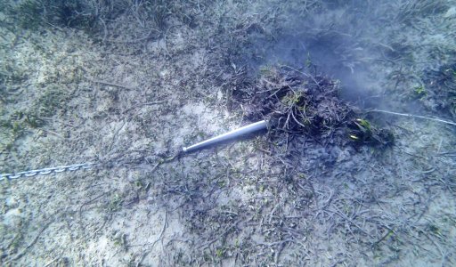

Steve Godwin aka the Panope Videos has, come out of retirement (?) and made a video, no 156, comparing Viking's Odin anchor with Ultra and the original Viking.
I have seen about 30% of the video and was then cut off. But if you Google you might gain access. I was cut off at the section where he does the cobblestone testing. I also did a quick scan before looking at the early parts of the vid (I anticipated problems) but did not see a summary spreadsheet.
If I find a way of watching the whole video and posting a link - I will do so.
Or as some members are supportive of Ukraine, which is where Viking has based its production, and someone might post the link
Jonathan
He seemed less impressed with the Odin than the Viking (which he still rates as the best over all) and notes that the Odin would not be as good as the Ultra if you have to have a non roll bar , though that does ignore that the Odin is under half the price of the Ultra!
Arguably, the most important parameter for a modern primary anchor is a consistently good performance over the range of substrates and situations likely to be encountered.
Unfortunately, in this test, the Odin did not do particularly well in this department.
