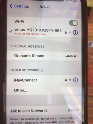

1. IT CONNECTS FINE TO BLUE TOOTH.

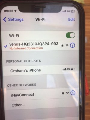

2. ON THE GX DISPLAY IT SHOWS CONNECTED TO THE NETWORK.. BUT WON'T FIND THE INTERNET WHEN I CHCK ON MY PHONE

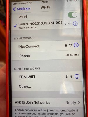

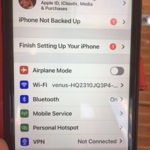

3. I OPEN MY IPHONE SEARCH Fro WIFI. it Finds the DONGLE VENUS Hq 2310 jq 3p4 etc.
4. my Phone finds the System on Bluetooth. When I select LOCAL on the Victron Connect APP
5. When I switch to VRM. it shows up " NO DEVICES FOUND"

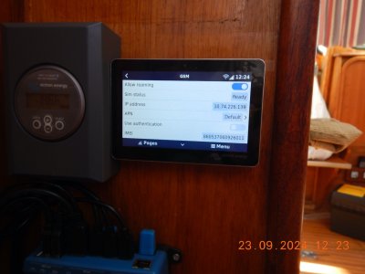

6. The Dongle Blue Light is FLASHING wetook out the SIMM and sent a message t Electrician Phone Seem to work..

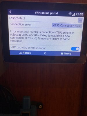

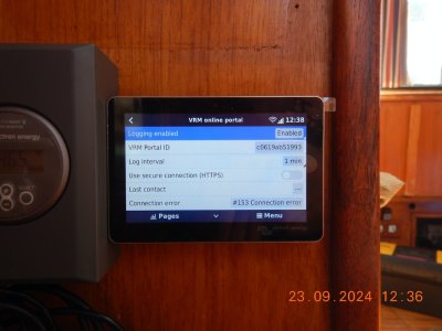

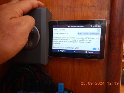

the GX touch on the VRM section comes up with an Error Error Message (urllib3.connection.httpconnection object at 0xb59aec28)
I will attach some Screen Shots photos of the Display

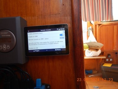

I can see the Devices Locally on Blue tooth BUT NOT when I switch to VRM

You can connect to the router. Using it for your phone to connect to the internet via the router's WiFi does not seem to work, is the SIM card still locked by the ISP?
I have a GSM router from Tp-Link that I tried to set up on the boat, but could not get it to work at all, the data SIM card was blocked and I had to return from Holland to Belgium where the SIM is from before I could unlock it, not taken the router back onboard just yet to try it out but it works locally in Belgium.

You are doing it all wrong. Forget Bluetooth. Do not connect your phone to the Cerbo, connect the Cerbo to something with internet, making the connection from the Cerbo. When connected you will see the wifi symbol in the top right corner of the touch screen. Pic 2 in post 1 shows you connected to the internet.
Now, connect the Cerbo to the portal.
You can now go to the portal on your phone, table, laptop etc. You connect using a web browser VRM Portal - Victron Energy
Create an account, enter the VRM portal ID and it should work.
