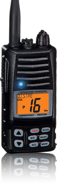

My VHF has been in the drawer for a couple months.
The battery is totally flat.
Got it out and put it in the charger.
The indicator light on the charger will not come on.
Any suggestions?
