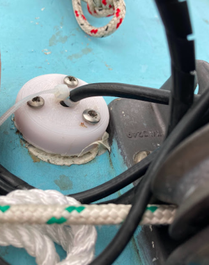

slawosz
26 Sep 2018
610
London
Or you could 3d print one for like 5p ;) Not as pretty as one from the shop, but works very well. The hole in the deck is larger than PL259 and have one length or RG8X cable.
