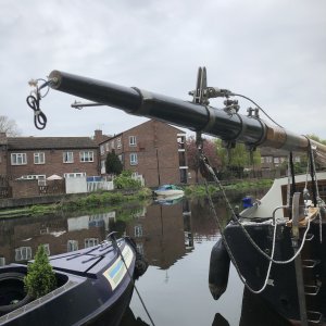

@Boathook OK thx. I guess I’d better test the cable first. It’s pretty old and it’s not coming out of the mast any time soon as you can see from this pic;

When selecting a new antenna do be aware that with a wooden mast you need an antenna that does not need a ground plane. ie one made for GRP cabin top mobo. Many antenna rely on the connection to the ali mast as the ground plane so not best for wooden mast. Also suggest you take back insulation on existing cable as you may find corrosion on wire so far back that you can not reliably get a connection. So need a new cable. ol'will

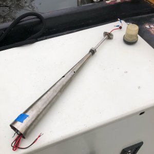

There's about 20cm of cable out the top, so hopefully it's not all coroded. I think I will have to jump it anyway to reach the antenna. Which means I can cut the cable supplied with whatever antenna to a short length and solder on a PL259.
That plug/socket connection would sit inside the stainless steel cone at the top. Is this an issue for ground or interference? Pic here:

Ah that stainless steel cone will work as a ground plane assuming it is longer than 17 inches. (1/4 wavelength) and assuming the antenna is on top of the cone. Next to it not so good. ol'will

@William_H Yes it’s 20”. But I am still figuring how to mount it, because the anchor light sits on the top.
Presumably if it’s to the side, the metal cone blocks the signal transmission. Is that correct?
Maybe it can go lower, adjacent only to wood ??

Not only blocks it, but completely changes the radiation pattern and if very close puts enough power back down the coax to overload the receiver.
st599
9 Jan 2006
7,529
Think of a TV "aerial" antenna, it has one element attached to the coax, all the others are not connected, their position just changes the radiation pattern making it highly directional.
Same thing with VHF antennas. Place metal nearby and they lose their omnidirectional pattern.
