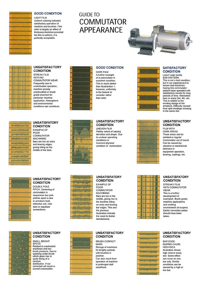

I would be looking at the condition and degree of wear of the brushes and also the state of the commutator.
